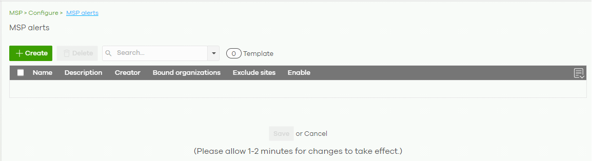

Label | Description |
+ Create | Click this button to add a new alert template (see Alert Settings). |
Delete | Click this button to remove alert templates already created. |
Search | Specify your desired search criteria to filter the list of alerts. |
selected in | This shows the number of alerts that match your filter criteria after you perform a search. |
Template | This shows the number of alert templates you have created. |
Name | This shows a descriptive name of the alert template. |
Description | This shows more details on the alert template. |
Creator | This shows your email address. |
Bound organizations | This shows All organizations or a list of the selected organizations to send alerts to. |
Exclude sites | This shows the sites that will not receive any alerts. |
Enable | Click this to activate the alert template. |
