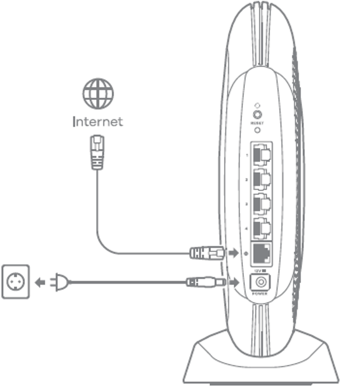

1 Use the included power cable to connect the Zyxel Device’s power port to a power outlet.
2 Connect the Internet port of the Zyxel Device to a broadband modem or router that is connected to the Internet.

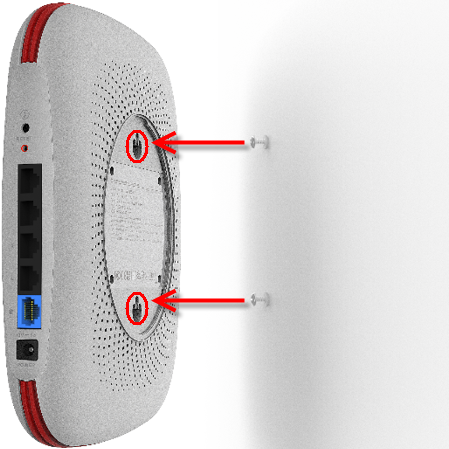

Wall Mounting
Use the wall mounting method to install your Zyxel Device. See
Zyxel Device Mounting Options for more information.

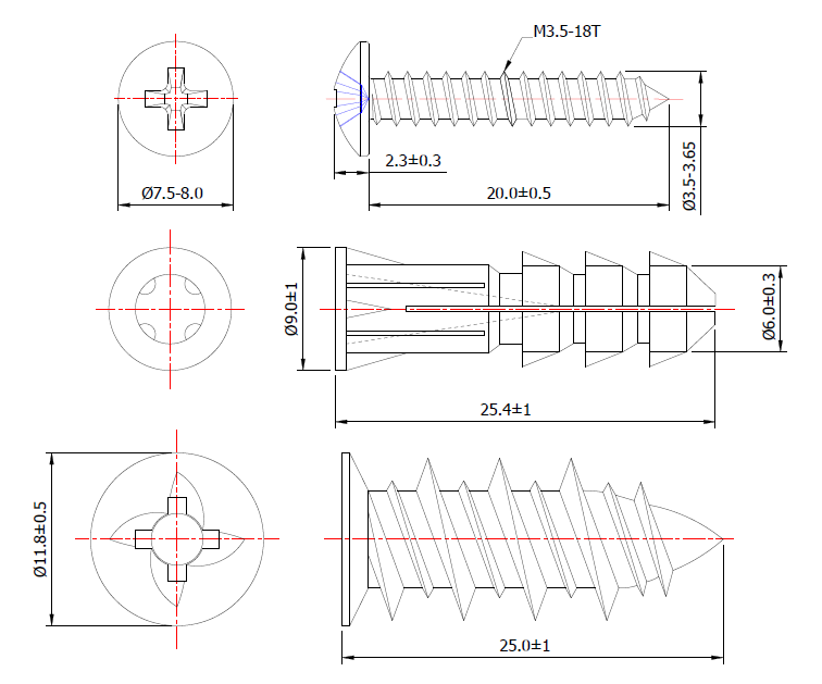

Mark a hole on the wall at least 2 meter-high from the ground level. Drill the hole and insert the included anchor and wall mount screw into the wall. Align the mounting hole on the Zyxel Device to the wall mount screw on the wall. Adjust the angle of the Zyxel Device to make sure it is secure in place.

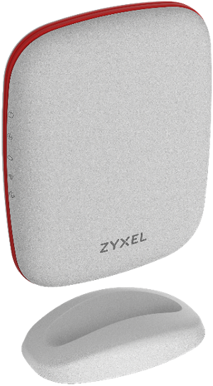

Desk Placement
You may place your Zyxel Device on a desk, table, shelf, and so on. See
Attach the bottom of the Zyxel Device to the magnetic stand. Then, place the Zyxel Device on a desk, table, shelf, and so on.

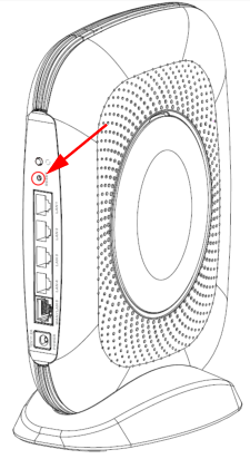

Reset Button
If you need to return the Zyxel Device to its default settings, use the RESET button on the rear panel.
Reset the Zyxel Device Back to Factory Default Settings
For a factory reset, press the
RESET button for at least 3 seconds or until the system (
) LED starts to blink green.

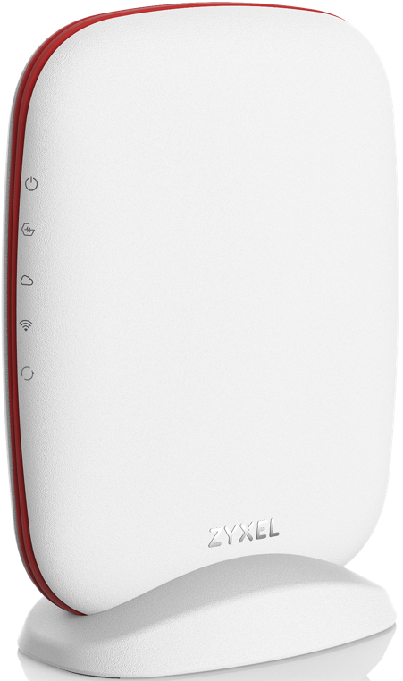

LED Light
Look at the LED behavior to determine the status of the Zyxel Devices. See
SCR 50AXE LED Descriptions for more information.
The following are the LED descriptions for your Zyxel Device.
