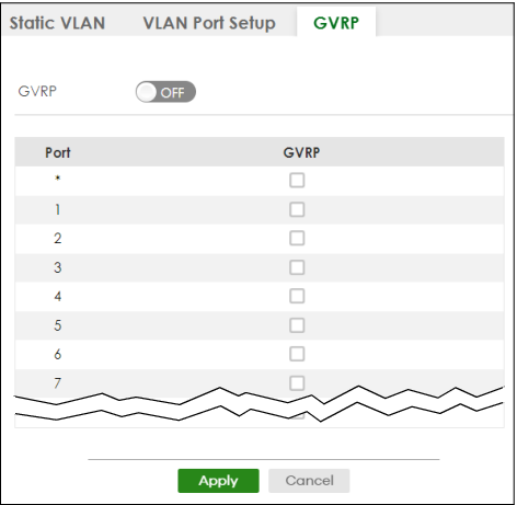

Use the GVRP screen (Configure GVRP) to enable/disable GVRP on each port.

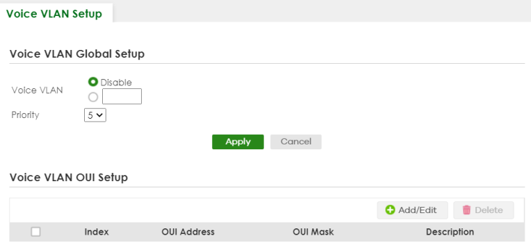

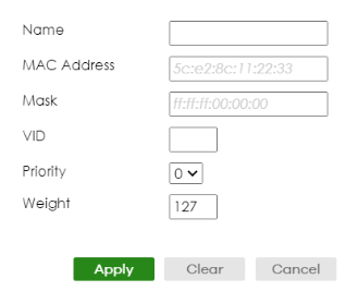

Use the Voice VLAN Setup screen (Voice VLAN) to set up VLANs that allow you to group voice traffic with defined priority and enable the Switch port to carry the voice traffic separately from data traffic to ensure the sound quality does NOT deteriorate.

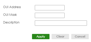

Use the Vendor ID Based VLAN Setup screen (Vendor ID Based VLAN) to set up VLANs that allow you to group untagged packets into logical VLANs based on the source MAC address of the packet. You can specify a mask for the MAC address to create a MAC address filter and enter a weight to set the VLAN rule’s priority.

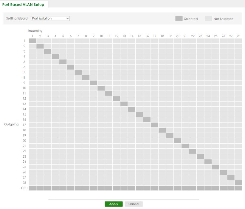

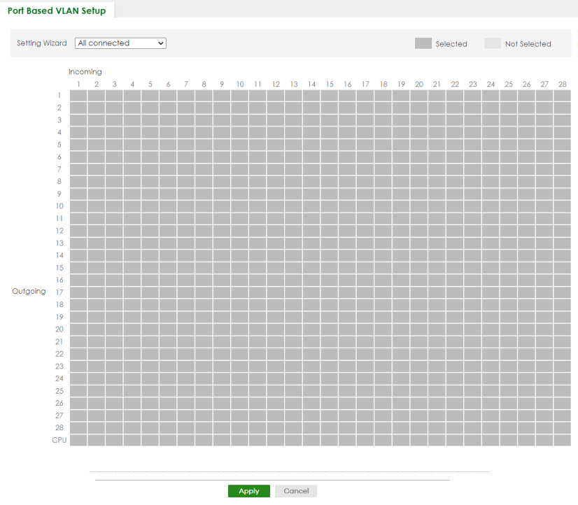

Use the Port-Based VLAN Setup screen (Port-Based VLAN Setup) to set up VLANs where the packet forwarding decision is based on the destination MAC address and its associated port.

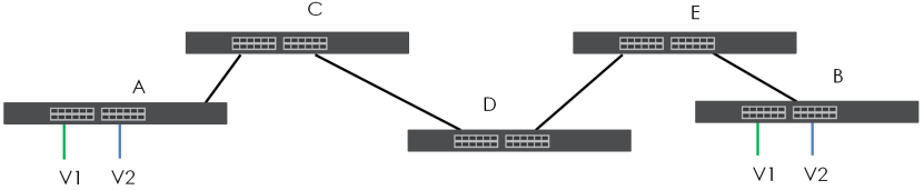

Refer to the following figure. Suppose you want to create VLAN groups 1 and 2 (V1 and V2) on devices A and B. Without VLAN Trunking, you must configure VLAN groups 1 and 2 on all intermediary switches C, D and E; otherwise they will drop frames with unknown VLAN group tags. However, with VLAN Trunking enabled on ports in each intermediary switch you only need to create VLAN groups in the end devices (A and B). C, D and E automatically allow frames with VLAN group tags 1 and 2 (VLAN groups that are unknown to those switches) to pass through their VLAN trunking ports.
Port VLAN Trunking

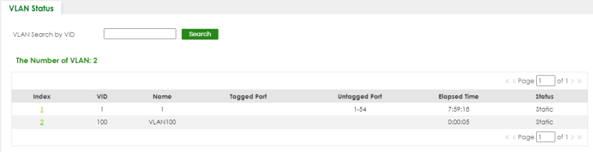

VLAN Status
Use this screen to view and search all static VLAN groups. Click SWITCHING > VLAN > VLAN Status from the navigation panel to display the screen as shown next.
label
description
VLAN Search by VID
Enter (an) existing VLAN ID numbers (use a comma (,) to separate individual VLANs or a hyphen (-) to indicate a range of VLANs. For example, “3,4” or “3-9”) and click Search to display only the specified VLANs in the list below.
Leave this field blank and click Search to display all VLANs configured on the Switch.
The Number of VLAN
This is the number of VLANs configured on the Switch.
The Number of Search Results
This is the number of VLANs that match the searching criteria and display in the list below.
This field displays only when you use the Search button to look for certain VLANs.
Index
This is the VLAN index number. Click an index number to view more VLAN details.
VID
This is the VLAN identification number that was configured in the corresponding VLAN configuration screen.
Name
This fields shows the descriptive name of the VLAN.
Tagged Port
This field shows the tagged ports that are participating in the VLAN.
Untagged Port
This field shows the untagged ports that are participating in the VLAN.
Elapsed Time
This field shows how long it has been since a normal VLAN was registered or a static VLAN was set up.
Status
This field shows how this VLAN was added to the Switch.
Dynamic – using GVRP
Static – added as a permanent VLAN

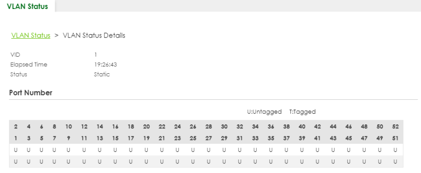

VLAN Details
Use this screen to view detailed port settings and status of the static VLAN group. Click an index number in the VLAN Status screen to display VLAN details.
SWITCHING > VLAN > VLAN Status > VLAN Status Details
label
description
VID
Elapsed Time
Status
Dynamic: using GVRP
Static: added as a permanent entry
Port Number
This section displays the ports that are participating in a VLAN. A tagged port is marked as T, an untagged port is marked as U and ports not participating in a VLAN are marked as ““.

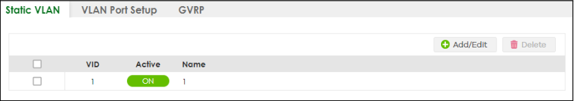

Configure a Static VLAN
Use this screen to view and configure a static VLAN for the Switch. Click SWITCHING > VLAN > VLAN Setup > Static VLAN to display the screen as shown next.
The following table describes the related labels in this screen.
label
Description
VID
This field displays the ID number of the VLAN group.
Active
This field indicates whether the VLAN settings are enabled or disabled.
Name
This field displays the descriptive name for this VLAN group.
Select an entry’s checkbox to select a specific entry. Otherwise, select the checkbox in the table heading row to select all entries.
Add/Edit
Click Add/Edit to add a new static VLAN or edit a selected one.
Delete
Click Delete to remove the selected static VLAN.

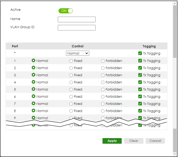

Add/Edit a Static VLAN
Use this screen to configure a static VLAN for the Switch. Click Add/Edit, or select an entry and click Add/Edit in the SWITCHING > VLAN > VLAN Setup > Static VLAN screen to display this screen.
SWITCHING > VLAN > VLAN Setup > Static VLAN > Add/Edit
label
Description
Active
Enable the switch button to activate the VLAN settings.
Name
Enter a descriptive name for the VLAN group for identification purposes. This name consists of up to 64 printable ASCII characters. The string should not contain [ ? ], [ | ], [ ' ], [ " ] or [ , ].
VLAN Group ID
Enter the VLAN ID for this static entry; the valid range is between 1 and 4094.
*Do NOT add a VLAN ID that has been used in the SWITCHING > VLAN > Voice VLAN Setup.
Port
The port number identifies the port you are configuring.
Use this row only if you want to make some settings the same for all ports. Use this row first to set the common settings and then make adjustments on a port-by-port basis.
*Changes in this row are copied to all the ports as soon as you make them.
Control
Select Normal for the port to dynamically join this VLAN group using GVRP. This is the default selection.
Select Fixed for the port to be a permanent member of this VLAN group.
Select Forbidden if you want to prohibit the port from joining this VLAN group.
Tagging
Select Tx Tagging if you want the port to tag all outgoing frames transmitted with this VLAN Group ID.

Configure GVRP
Use this screen to configure GVRP settings on a port. Click SWITCHING > VLAN > VLAN Setup > GVRP to display the screen as shown.
label
description
GVRP
GVRP (GARP VLAN Registration Protocol) is a registration protocol that defines a way for switches to register necessary VLAN members on ports across the network.
Enable the switch button to permit VLAN groups beyond the local Switch.
Port
This field displays the port number.
GVRP
Select this checkbox to allow GVRP on this port.
Apply
Cancel
Voice VLAN
Voice VLAN is a VLAN that is specifically allocated for voice traffic. It ensures that the sound quality of an IP phone is preserved from deteriorating when the data traffic on the Switch ports is high. It groups the voice traffic with defined priority into an assigned VLAN which enables the separation of voice and data traffic coming onto the Switch port.
The Switch can determine whether a received packet is
an untagged voice packet when the incoming port is a fixed port for voice VLAN.
a tagged voice packet when the incoming port and VLAN tag belongs to a voice VLAN.
It then checks the source packet’s MAC address against an OUI list. If a match is found, the packet is considered as a voice packet.
You can set priority level to the Voice VLAN and add MAC address of IP phones from specific manufacturers by using its ID from the Organizationally Unique Identifiers (OUI).
Click SWITCHING > VLAN > Voice VLAN Setup to display the configuration screen as shown.
The following table describes the fields in the above screen.
label
description
Voice VLAN Global Setup
Voice VLAN
Click the second radio button if you want to enable the Voice VLAN feature. Enter a VLAN ID number that is associated with the Voice VLAN.
Click the Disable radio button if you do not want to enable the Voice VLAN feature.
Priority
Select the priority level of the voice traffic from 0 to 7. Default setting is 5. The higher the numeric value you assign, the higher the priority for this voice traffic.
Apply
Cancel
Click Cancel to begin configuring this section afresh.
Voice VLAN OUI Setup
Index
This field displays the index number of the Voice VLAN.
OUI Address
This field displays the OUI address of the Voice VLAN.
OUI Mask
This field displays the OUI mask address of the Voice VLAN.
Description
This field displays the description of the Voice VLAN with OUI address.
Add/Edit
Click Add/Edit to add a new entry or edit a selected one.
Delete
Click Delete to remove the selected entry.
Add/Edit a Voice VLAN
Click Add/Edit, or select an entry and click Add/Edit in the SWITCHING > VLAN > Voice VLAN Setup screen to display the configuration screen.
SWITCHING > VLAN > Voice VLAN Setup > Add/Edit
label
description
OUI Address
Enter the IP phone manufacturer’s OUI MAC address. The first 3 bytes is the manufacturer identifier, the last 3 bytes is a unique station ID.
OUI Mask
Enter the mask for the specified IP phone manufacturer’s OUI MAC address to determine which bits a packet’s MAC address should match.
Enter “f” for each bit of the specified MAC address that the traffic’s MAC address should match. Enter “0” for the bits of the matched traffic’s MAC address, which can be of any hexadecimal characters. For example, if you set the MAC address to 00:13:49:00:00:00 and the mask to ff:ff:ff:00:00:00, a packet with a MAC address of 00:13:49:12:34:56 matches this criteria.
Description
Enter a description up to 32 printable ASCII characters except [ ? ], [ | ], [ ' ], or [ " ] for the Voice VLAN device. For example: Siemens.
Apply
Clear
Click Clear to clear the fields to the factory defaults.
Cancel
Click Cancel to not save the configuration you make and return to the last screen.

Add/Edit a Vendor ID Based VLAN
Click Add/Edit, or select an entry and click Add/Edit in the SWITCHING > VLAN > Vendor ID Based VLAN Setup to see this screen.
SWITCHING > VLAN > Vendor ID Based VLAN Setup > Add/Edit
label
description
Name
Enter a name up to 32 alphanumeric characters except [ ? ], [ | ], [ ' ], or [ " ] for the vendor ID based VLAN entry.
MAC Address
Enter a MAC address that is bind to the vendor ID-based VLAN entry. This is the source MAC address of the data packet that is looked up when untagged packets arrive at the Switch.
Mask
Enter the mask for the specified source MAC address to determine which bits a packet’s MAC address should match.
VID
Enter an ID (from 1 to 4094) for the VLAN that is associated with the vendor ID based VLAN entry.
Priority
Select the priority level that the Switch assigns to frames belonging to this VLAN. The higher the numeric value you assign, the higher the priority for this vendor ID based VLAN entry.
Weight
Enter a number between 0 and 255 to specify the rule’s weight. This is to decide the priority in which the rule is applied. The higher the number, the higher the rule’s priority.
Apply
Clear
Cancel
Port-based VLANs are VLANs where the packet forwarding decision is based on the destination MAC address and its associated port.
Port-based VLANs require allowed outgoing ports to be defined for each port. Therefore, if you wish to allow two subscriber ports to talk to each other, for example, between conference rooms in a hotel, you must define the egress (an egress port is an outgoing port, that is, a port through which a data packet leaves) for both ports.
Port-based VLANs are specific only to the Switch on which they were created.
*When you activate port-based VLAN, the Switch uses a default VLAN ID of 1. You cannot change it.
*In screens (such as SYSTEM > IP Setup and SWITCHING > Static MAC Filtering) that require a VID, you must enter 1 as the VID.
The port-based VLAN setup screen is shown next. The CPU management port forms a VLAN with all Ethernet ports.
Configure a Port-Based VLAN
Select Port Based as the VLAN Type in the SYSTEM > Switch Setup screen and then click SWITCHING > VLAN from the navigation panel to display the next screen.
SWITCHING > VLAN > Port Based VLAN Setup (All Connected)
SWITCHING > VLAN: Port Based VLAN Setup (Port Isolation)
label
Description
Setting Wizard
Choose Current configuration to display the Switch’s current port-based VLAN configuration.
Choose All connected or Port isolation wizard to quickly set up a port-based VLAN according to the below descriptions.
All connected means all ports can communicate with each other, that is, there are no virtual LANs. All incoming and outgoing ports are selected. This option is the most flexible but also the least secure.
Port isolation means that each port can only communicate with the CPU management port and cannot communicate with each other. All incoming ports are selected while only the CPU outgoing port is selected. This option is the most limiting but also the most secure.
After selecting the setting wizard, you can customize the port settings. Click on the ports to add or delete incoming or outgoing ports. The configuration will be saved only after you click Apply at the bottom of the screen.
Incoming
These are the ingress ports; an ingress port is an incoming port, that is, a port through which a data packet enters. If you wish to allow two subscriber ports to talk to each other, you must define the ingress port for both ports. The numbers in the top row denote the incoming port for the corresponding port listed on the left (its outgoing port). CPU refers to the Switch management port. By default it forms a VLAN with all Ethernet ports. If it does not form a VLAN with a particular port then the Switch cannot be managed from that port.
Outgoing
These are the egress ports; an egress port is an outgoing port, that is, a port through which a data packet leaves. If you wish to allow two subscriber ports to talk to each other, you must define the egress port for both ports. CPU refers to the Switch management port. By default it forms a VLAN with all Ethernet ports. If it does not form a VLAN with a particular port then the Switch cannot be managed from that port.
Apply
Cancel
